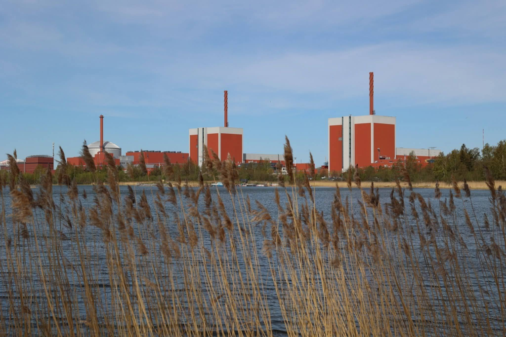

Foto: Finland-Olkiluoto-Olkiluoto Nuclear Power Plant-Photo ©Piergiorgio Pescali
